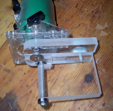

Arnt, someone else asked, but I too want to fully understand this tool you've made. I appreciate it's simplicity, but don't understand the adjustment in and out. I understand that the router has an adustment for depth.
What I'm wondering about is the width. Can you explain or offer another pic or two? TIA, Bruce
PostPosted: Wed Feb 08, 2006 12:15 pm
Bruce, Arnt,
I'll jump in here. It's the middle of the night in Norway!
I built one modelled after Arnt's, along with a vise using pony clamps to hold the guitar body on the front of my bench while routing.
The large piece with the bearings sits in a slot in the base (the base being that which the trimmer is bolted to) and can be moved forward or back (north and south in the pic).
In using it, I found it helpful to hold it by the piece with the bearings (I have a small lam trimmer), not by the trimmer. Simplicity in itself, and worked very well. Thanks, Arnt!burbank38756.8456018519

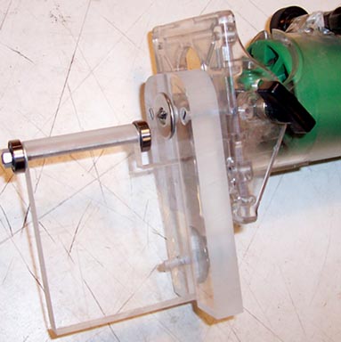

Hey guys (just logged on, it's 08:30 here now), yes it functions like the jigs you mention. I saw a similar system in use at Martin, and "Factory Friday" at Taylor and Julius Borges website shows the same principle in use as well. The bottom part of the jig can be moved in-out in the rabbet in the top part, and is secured with a wing nut and a screw that is tapped into the top part.
I don't have a picture of it in use, but here is another snapshot of it:
PostPosted: Thu Feb 09, 2006 12:05 am
Okay Arnt. So there is no micrometer adjustment, just trial and error on the side depth adjust.
We run into this on our StewMac circle cutters, Just a screw, trial and error to set the thing. A screw mechanism like on my chainsaw is all that's needed.
I love the look of your tool, I've never used plastic stuff like this. What is it and who supplies it?
PostPosted: Thu Feb 09, 2006 12:16 am
You are right Bruce, it's trial and error. However, I made the rabbet pretty tight, so I can tap lightly with a hammer for "micro" adjustment, sort of like a wooden plane. Sounds crude, but it's not that bad, it IS a "practice on scrap" deal of course. I thought about adding a screw adjustment of some sort, but unless the tolerances were pretty tight I feared that the backlash / slop would make it unpractical. I'm sure you could come up with something that works though.
